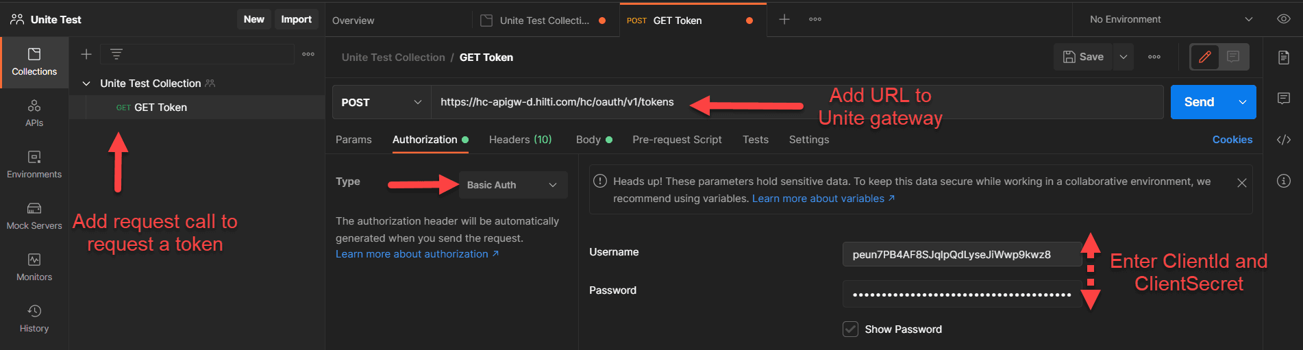

- Open and launch Postman, create a new workspace, and add a new collection for your API calls by clicking on "+"
- Select request method "POST" and enter the following request URL for the call to retrieve an access token:
URL for the post call to get the access token:
https://cloudsso.hilti.com/hc/token
- Select the "Authorization" tab and set Type to "Basic Auth". Enter the "Client ID" and "Client Secret" into respectively, the "Username" and "Password" fields.

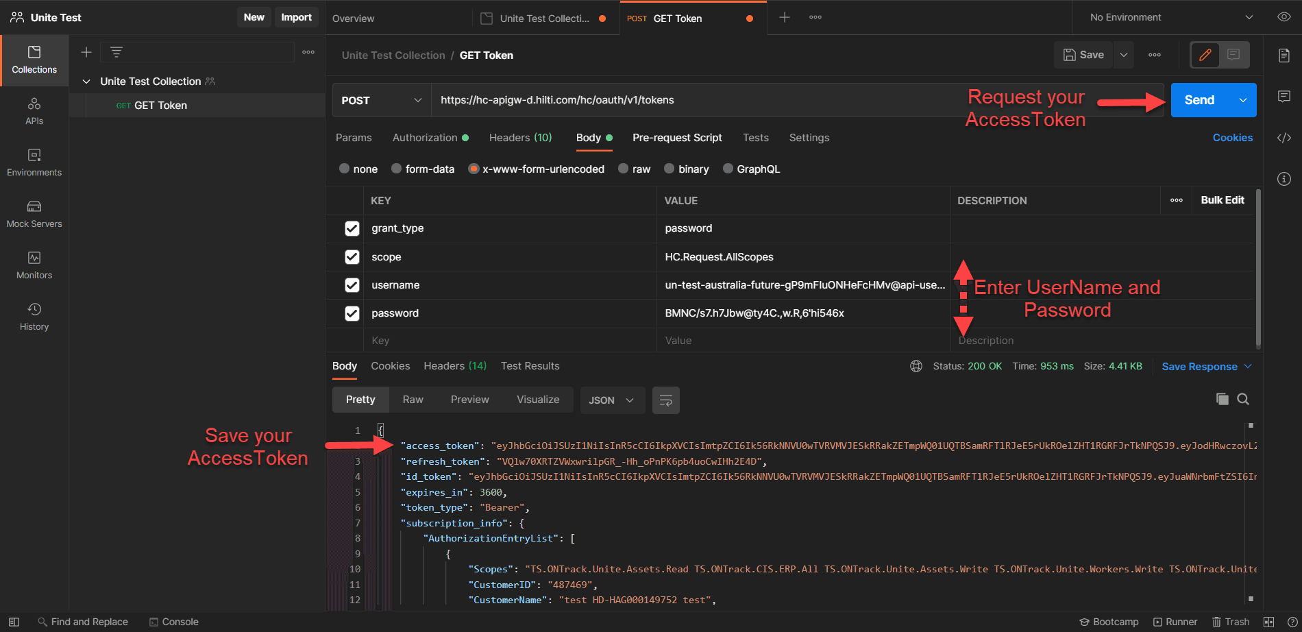

- Select the "Body" tab, pick "x-www-form-urlencoded" and add the following data:
| Key | Value |
| grant_type | password |
| username | Username of technical user |
| password | Password of technical user |
- Hit "Send", receive your access token and store it in your IDE (for that, make sure you have selected the right environment, see top right of the Postman screen)

The token lifecycle is designed the following way:
- Get a new access token
- The token remains valid for 60 min
- Cache the token and do not request a new one for each API call
- After the token expires request a new token
